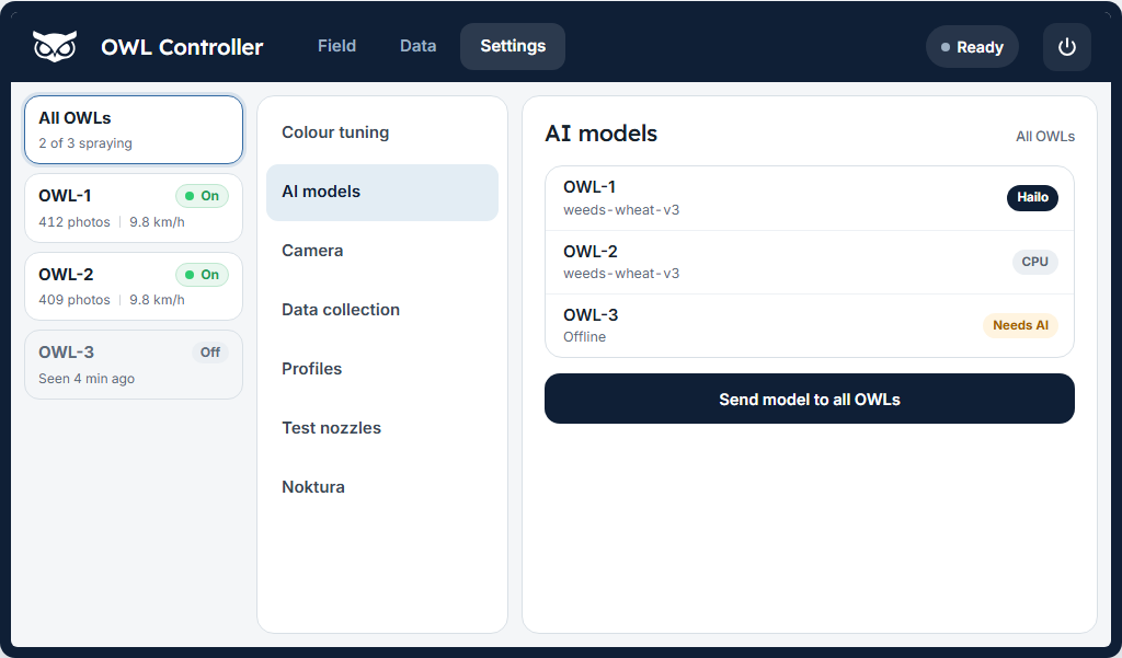

Networked Field screen
Networked Settings screen
The OWL rail. All OWLs is selected when the screen opens, and every control then acts on every OWL. Below it is one card per OWL with its state (On, Rec, Ready, Fault or Off), photos this run and speed. An OWL that drops out keeps its card, greyed, with Seen x min ago. Tap an OWL to see its camera and control it on its own; tap All OWLs to go back.

Settings. A side list next to the rail:

AI models
All OWLs: one row per OWL with its model and where its AI runs (Hailo, CPU or Needs AI), Send model to all OWLs (the model library page) and Install AI for OWLs without it. One OWL: its models, classes to spray, tracking, AI confidence and crop buffer

Tuning detection (Settings > Colour tuning)
Settings > Colour tuning tunes detection on the OWLs selected in the rail (all of them when All OWLs is selected). The model is: make a change, see it take effect, then save it under a name you choose.
  • Sliders apply live. Dragging a threshold slider (green, hue, saturation, brightness, smallest weed) pushes the change to the selected OWLs immediately. Nothing is saved yet.
  • Apply to OWLs also pushes any changes made in Settings > Advanced (the INI editor) live, without saving.
  • Save as profile opens a dialog where you give the setup a name and optional notes, and tick Make active on reboot. The config is stored in the controller library and on each OWL’s disk. A date is appended automatically so saves never overwrite each other. If a saved config is currently selected, the dialog also offers Update “<name>” to overwrite it in place instead of creating a new file.
  • Settings > Profiles lists saved configs by name and date; selecting one shows its notes and save date beneath. Load on OWLs applies one live; Use on startup makes the selected config the one OWLs load on reboot. The running profile shows at the top of Profiles, with OWLs differ when the OWLs run different thresholds.
Mount geometry is separate
Detection configs do not include the crop or actuation band: that is per-unit mount geometry kept in each OWL’s GEOMETRY.ini. Loading or saving a detection config never changes a unit’s geometry. Use Crop and spray zone (below) to change it.
  • Restart notice. A few settings (camera resolution, relay_num) can’t change live. If you edit one, a notice appears on Field and in Profiles with Restart OWLs.
Visual geometry editor
Tap Crop and spray zone in Settings > Colour tuning (or Settings > Camera) to drag the crop and actuation band directly on the live feed. The editor automatically switches that OWL’s preview to the full uncropped frame while open (and back to the normal cropped view when you close), so the overlay always lines up — you don’t need to touch detection.
  • Drag the four edge handles to crop independently from the left, right, top and bottom — useful to exclude a boom, wheel track, or shaded edge. The relay lane lines redraw as you drag so you can see them recenter across the cropped width.
  • Drag the two band handles to set the actuation band — a weed fires its relay only while its centre is inside the band. Raise the top to ignore weeds too far ahead; lower the bottom to ignore weeds too close.
  • Use the nudge buttons for fine adjustment in a bumpy cab.
  • Done saves the geometry to that OWL’s GEOMETRY.ini (it persists across reboots). Cancel reverts to how it was when you opened the editor. Tick Apply to all OWLs before Done to write the same geometry to every connected unit (handy for an identically-mounted boom).
These same values can be set by hand in GEOMETRY.ini (crop_left/right/top/bottom, actuation_top/bottom) — see Configuration — so OWLs running without a controller get the feature too.
Two feeds side by side + zoom
With more than one OWL you can tune two at once. Use the 1 feed / 2 feeds toggle, and pick which OWL shows in each slot. Both feeds show their own crop/band handles and are dragged independently — each feed pushes to its own OWL. Tap a feed to make it active (highlighted); the shared controls panel then acts on that one. Apply to all OWLs still copies the active feed’s geometry to every unit.
Each feed has its own zoom: the - and + buttons (or scroll wheel / pinch) magnify the feed and its overlay together so you can place edges precisely on small weeds or rows; drag the feed to pan when zoomed in. Zoom is purely a closer look — the crop fractions don’t change.
Note
The normal live feed always shows the cropped frame (what the detector sees), with detection on or off. Only the geometry editor temporarily shows the full frame.
